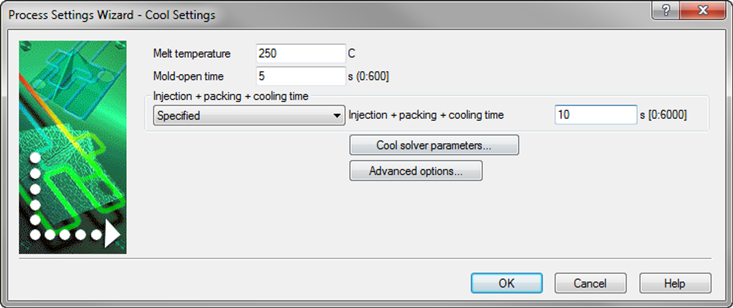

  5. Click (Home tab > Molding Process Setup panel > Process Settings).
  6. Ensure that the Melt temperature is 250° C.
  7. Ensure that the Mold-open time is 5 seconds.
  8. Set the Injection + Packing + Cooling time to 10 seconds.
  9. Click OK.
