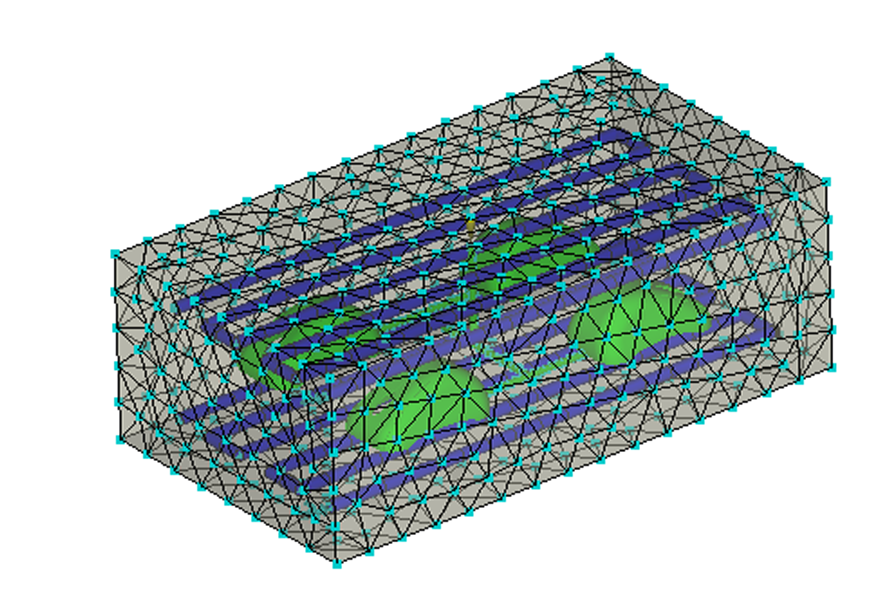

Create the Mold Boundary

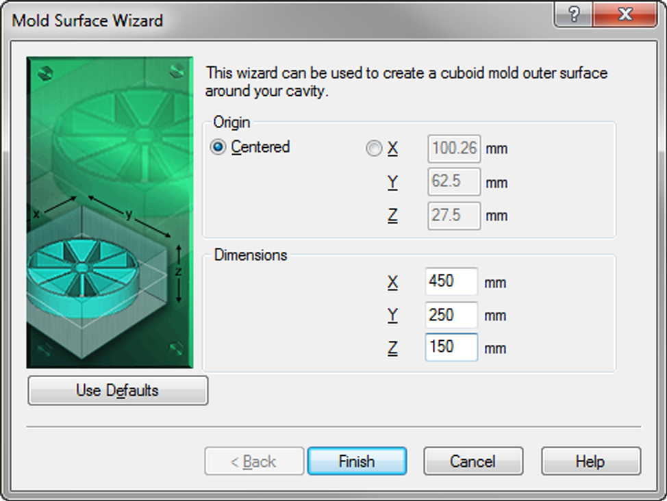

In this task, you use the Mold Surface Wizard to create a mold boundary.
  1. Click Geometry > Create > Mold Surface.
  2. Enter 450 for the X-dimension.
  3. Enter 250 for the Y-dimension.
  4. Enter 150 for the Z-dimension.
  5. Click Finish
  6. Uncheck the Mold surface (default)(Elements) layer.
