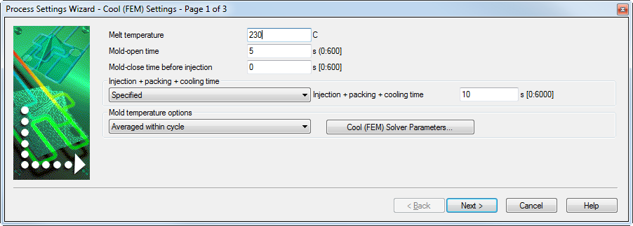

Ensure that the Melt temperature is 250°C.
Ensure that the Mold-open time is 5 seconds
Ensure that the Mold-close time before injection is 0 seconds.
Set the Injection + Packing + Cooling time to 10 seconds.
Ensure that the Mold temperature options are set to Averaged within cycle.
Click Next.

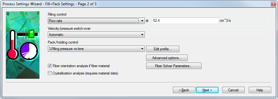

Ensure that the filling control is Flow rate at 52.4 cm^3/s
Ensure that the Pack/holding control is %Filling pressure vs time.
Click Edit profile and ensure that the profile is 0 - 80, 5 - 80, then click OK.
Click Next.

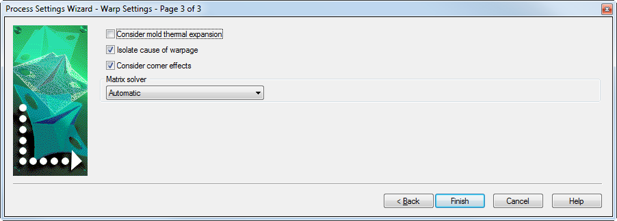

Check Isolate cause of warpage.
Check Consider corner effects.
Click Finish.
