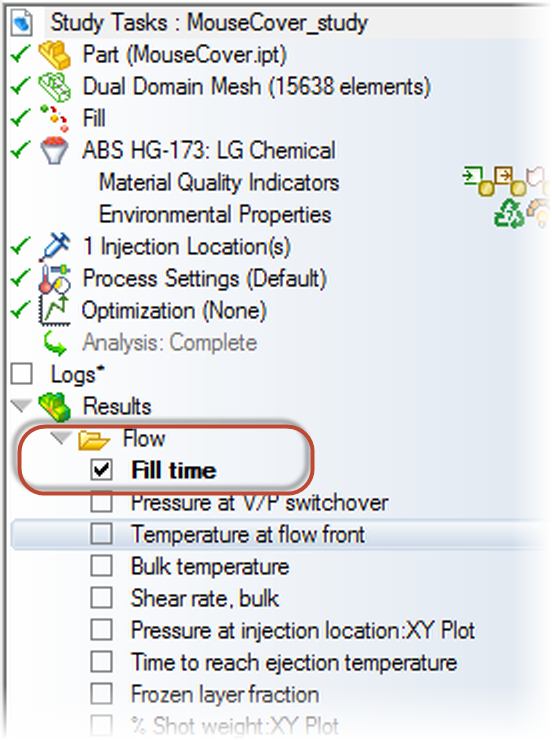

In this step, you review the fill time results.
Click the Results tab to open the Results panel.
Click Fill Time in the Study Tasks list.
Rotate, Pan, and Zoom the model as necessary to inspect the fill time result.
