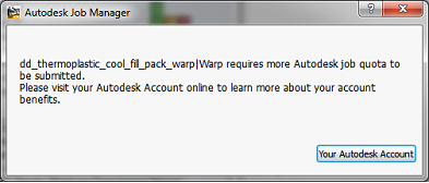

If you have insufficient Jobs left in your account, and you send an analysis to the Cloud, the analysis will fail and you will receive an error message.
For example, if you send an analysis sequence such as Cool+Fill+Pack+Warp to the Cloud, with only two (2) Jobs left in your account, the first two analyses will run successfully and the third (Warp) will fail with a message similar to the one below.
