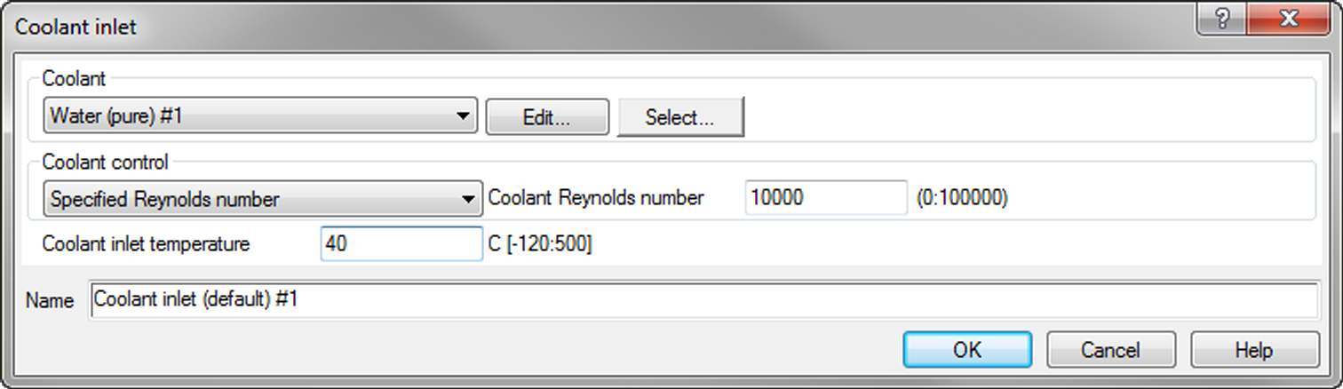

  1. With the Select tool from the Navigation Toolbar, select one of the coolant inlets.
  2. Right click and select Properties.
  3. Repeat steps 1-3 for the other coolant inlet.
  4. Set the Coolant inlet temperature to 40° C, and Click OK.

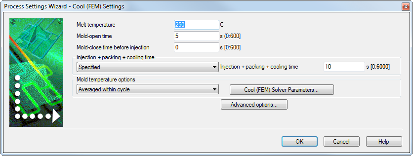

  5. Click (Home > Molding Process Setup > Process Settings).
  6. Ensure that the Melt temperature is 250°C.
  7. Ensure that the Mold-open time is 5 seconds.
  8. Set the Injection + Packing + Cooling time to 10 seconds.
  9. Ensure that the Mold-close time before injection is 0 seconds.
  10. Set the Mold temperature options to Averaged within cycle.
  11. Click OK.
