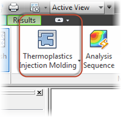

Click to see the other molding processes that are available. Keep Thermoplastics Injection Molding as the molding process.

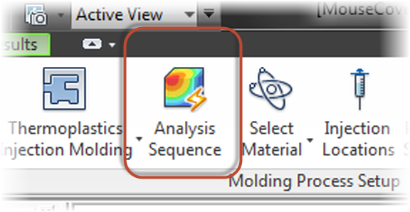

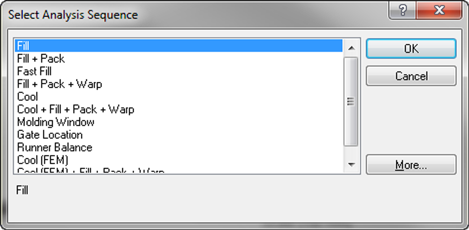

Click to see the analysis sequences that are available. Ensure that the analysis sequence is Fill.

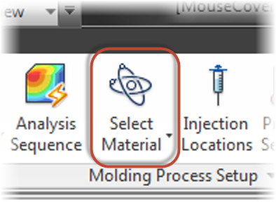

Click .

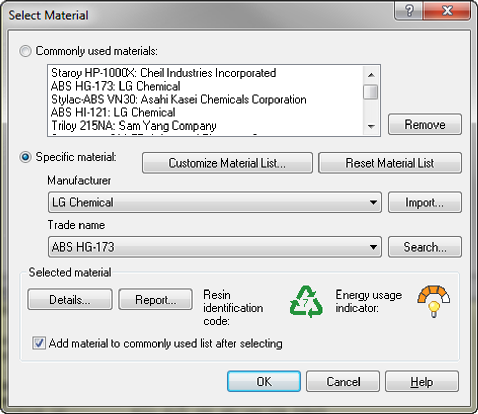

Select LG Chemical as the Manufacturer.
Select ABS HG-173 as the Trade Name.
