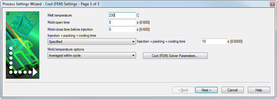

  1. Click ( Home tab > Molding Process Setup panel > Process Settings).
  2. Ensure that the Melt temperature is 250°C.
  3. Ensure that the Mold-open time is 5 seconds
  4. Ensure that the Mold-close time before injection is 0 seconds.
  5. Set the Injection + Packing + Cooling time to 10 seconds.
  6. Ensure that the Mold temperature options are set to Averaged within cycle.
  7. Click Next.

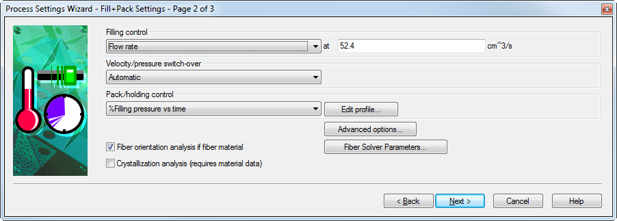

  8. Ensure that the filling control is Flow rate at 52.4 cm^3/s
  9. Ensure that the Pack/holding control is %Filling pressure vs time.
  10. Click Edit profile and ensure that the profile is 0 - 80, 5 - 80, then click OK.
  11. Click Next.

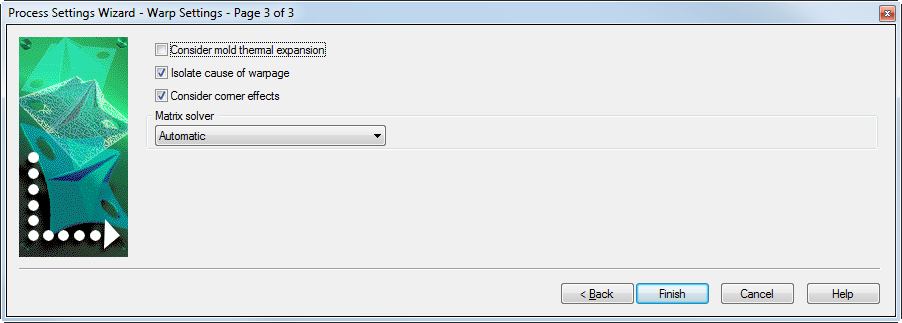

  12. Check Isolate cause of warpage.
  13. Check Consider corner effects.
  14. Click Finish.
