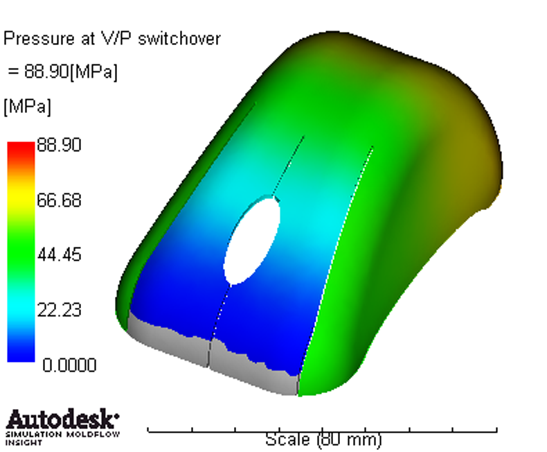

In this step, you review the Pressure at the Velocity / Pressure switch over results.
Click Pressure at V/P switchover in the Study Tasks list.
Rotate, Pan, and Zoom the model as necessary to inspect the fill time result.
Click to animate the result. Use the other animation tools to see what they do.
Rotate the part similar to the plot.
Click to show the value at a specific location on the part. Use the CTRL key when clicking the part to select more than one location.
