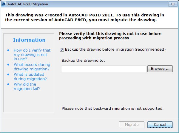

    The Drawing Migration wizard starts.
  4. Verify that the drawing file is closed.
  5. On the Drawing Migration Launch page, select Backup the Drawing Before Migration (Recommended), if it is not already selected.
    Note:
    It is recommended that you backup your drawing in case it requires further work in AutoCAD P&ID 2011.
  6. Click Browse and specify a location to store the backup file.

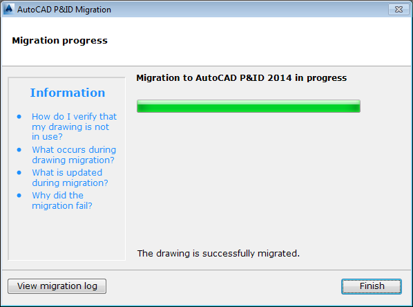

  7. Click Migrate. The Drawing Migration Progress page indicates the progress of the migration.
  8. Click Finish. The drawing opens in your AutoCAD P&ID 2015 project.
