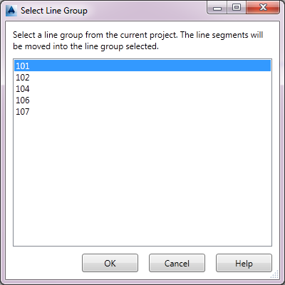

The above image shows line number 101 and an unassigned ( ? ) line selected.
You can use slregoup to set the unassigned line to an existing line number (line group tag value).
The selected unassigned line number is now in line group 101, which partially sets the default line segment tag.

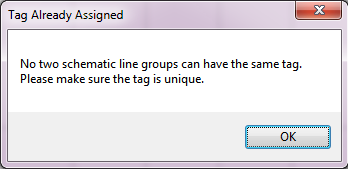

Note: With the introduction of slregroup in AutoCAD Plant 3D Extension 2, pipe lines are no longer automatically added to existing groups if you assign identical tags. Instead, a Tag Already Assigned dialog box displays and the tag assignment is cancelled.
Line Group Tag Management
No two different schematic line groups can have the same tag because the tag identifies the group. This can prevent you from assigning an existing line number to a line segment.
If an operation attempts to assign an existing tag and cannot be interrupted, a question mark ( ? ) is added to the tag temporarily. You can later use the assigntag command or Data Manager to resolve this.
