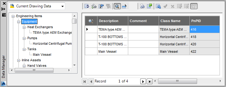

A tree view in the left pane of the Data Manager displays object views, customized views, or reports. The data view in the right pane displays properties for the selected view or report.

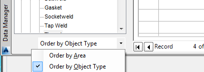

When viewing a Plant 3D drawing, you see a drop-down list that offers these choices:
You can change the way the tree is organized, by choosing area or object type.
Shortcut Menu: Tree view

Data Manager Toolbar
Provides buttons that export and import data, accept and reject pending changes, filter or zoom, and so on.
  • Drop-down List. Sets the Data Manager view. You can choose drawing data, project data, or project reports. You can also select a customized view, if one is available.
