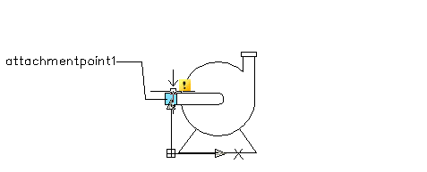

- On the Parameters tab of the Block Authoring palette, click Point Parameter, and place a parameter (for example: on the inlet of the pump).
- Right-click the parameter. Click Properties.
- In the Properties palette, under Property Labels, click Position Label. Enter attachmentpoint1.
- Click a blank space in the drawing, and then press ESC.

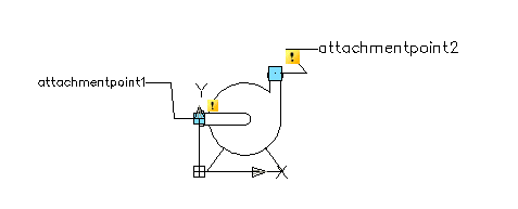

- Create another parameter (for example: at the outlet of the pump), and label it attachmentpoint2.
- Save the changes and close the Block Editor.

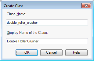

- In the Create Class dialog box, enter a name for the new class definition (for example: horizontalcentrifugalpump) and a display name (horizontal centrifugal pump).
- Click OK.
