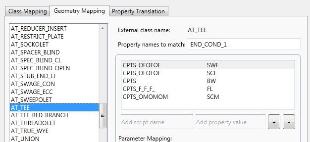

Each script has associated properties that indicate how the endtypes are to be drawn. AutoPLANT or CADWorx properties are matched to AutoCAD Plant 3D versions. In many cases, you may want a class to have different shapes, depending on context. For example, you may want AT_TEE (AutoPLANT) or Tee (CADWorx) to have a welded tee, a socked-welded tee, or a flanged tee in different locations. You can specify a property name or names to match as criteria for the graphical shape to be used.
Note: The following examples use AutoPLANT data but apply conceptually to CADWorx data as well.
For AT_TEE, for example, you can specify the external property END_COND_1 as the matching criteria to help differentiate when to use the different shapes. Following is an example that specifies using CPTS_OFOFOF when END_CONDITION_1 is SWF or SCF, but using CPTS when END_CONDITION_1 is BW, and so on.
For each geometry mapping there is also a corresponding set of parameters, and these can vary depending on the shape. The image that follows shows a Plant 3D threaded female tee in the catalog editor (size tab) along with its parameters.
You can enter these parameters in the mapping table in the Plant 3D Parameter Name column and map them to the corresponding AutoPLANT property name (or value).
