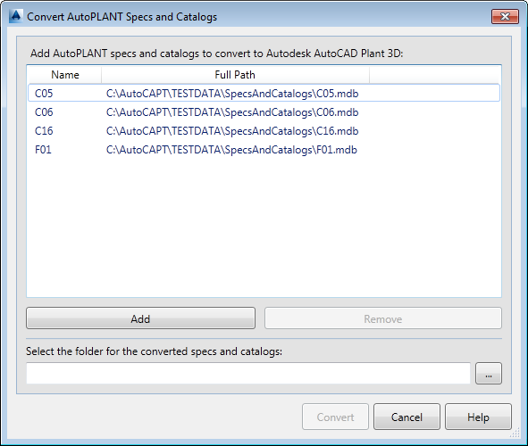

To convert AutoPLANT specs (or catalogs)
  1. On the File menu, click Convert AutoPLANT Specs and Catalogs.
  2. In the Convert AutoPLANT Specs and Catalogs dialog box, click Add.
  3. In the Select Specs and Catalogs dialog box, navigate to the folder containing the specs you want to convert. Select one or more specs and click Open.
  4. In the Convert External Specs and Catalogs dialog box, under Select the Folder For the Converted Specs and Catalogs, click the [...] button and browse to the folder where you want to save the converted files. Click OK.
  5. In the Convert External Specs and Catalogs dialog box, click Convert. A dialog box displays the progress of the conversion.
  6. In the Specs and Catalogs - Conversion Complete dialog box, do one of the following:
    • View the Spec Conversion Report dialog that lists the Output Folder, the date of the conversion, and the name of the mdb file converted. In this dialog box, you can click the link Click Here To View Conversion Report to display the information in text format.
    • Open the converted specs folder where you can view log files and converted files.
  7. Based on the conversion results, you can either adjust mappings as needed and run the conversion again or open the spec and add parts from a Plant 3D catalog.
