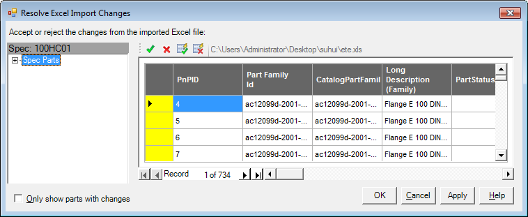

Resolve Excel Import Changes Dialog Box
Resolves changes made to imported Excel files.
When you import Spec or Catalog parts, you can specify which changes to accept and which to reject. Importing data into the Spec Editor is like importing data into the AutoCAD Plant 3D Data Manager. For more information, see Accept and Reject Edits.
