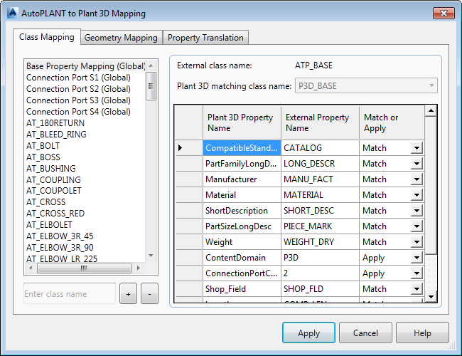

Class Mapping Tab (AutoPLANT to Plant 3D Class Mapping Dialog Box)
Maps global and individual class AutoPLANT properties to Plant 3D equivalents.

Global class properties (first five items in the list on the left pane)
Lists global properties that apply to all classes. Once these properties are mapped, you need not map them again for individual classes.
If, however, you want to override a global mapping for a specific class, you map that class appropriately and its mapping takes precedence over the global mapping. For example, you can specifically map AT_TEE to MyCatalog instead of CATALOG, and all classes except AT_TEE are mapped to CATALOG. Only AT_TEE has the MyCatalog mapping.
External class names (remaining items in the list on the left pane)
Lists AutoPLANT class names that can map to a Plant 3D class.

External class name
Displays the AutoPLANT class name selected from the External Class Names list on the left pane.
Plant 3D matching class name
Specifies the Plant 3D class that corresponds to the AutoPLANT class selected on the left pane. When you select one of the global mappings this field is read-only.
Plant 3D Property Name
Specifies the Plant 3D properties that you want mapped to the AutoPLANT properties for the class selected on the left pane.
External Property Name
Specifies the AutoPLANT properties for the class selected on the left pane.
Match or Apply
Specifies whether you want to match the properties or apply a specific property value. For example, for the AutoPLANT AT_BOLT class, the Plant 3D Length property is set to match AutoPLANT Bolt_len. But the Plant 3D PartCategory property is set to the specific value Fasteners.
