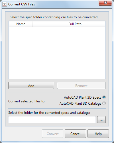

  1. On the File menu, click ConvertCSV files.
  2. In the Convert CSV Files dialog box, click Add.
  3. In the Browse For Folder dialog box, navigate to the folder containing the CSV files you want to convert. Click OK.
  4. In the Convert CSV Files dialog box, do the following.
    • Next to Convert Selected Files To, click AutoCAD Plant 3D Specs or AutoCAD Plant 3D Catalogs, depending on the data contained in the CSV files.
    • Under Select the Folder For the Converted Specs and Catalogs, click the [...] button and browse to the folder where you want to save the converted files. Click OK.
    • Click Convert. A dialog box displays the progress of the conversion.
