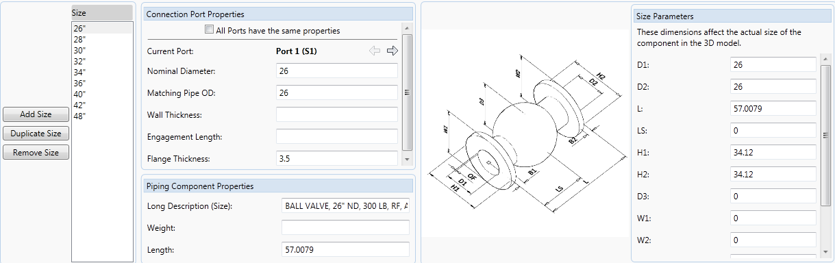

Catalog Editor - Sizes tab
Sets component size properties
Size
Displays sizes for the component.
Add Size
Adds a new size to the list. The new size is listed as undefined in the size list. You can specify the Nominal Diameter after adding to set the size.
Duplicate Size
Copies the properties and dimensions of the size selected in the Size list. The new size is listed as undefined until it is assigned a unique Nominal Diameter.
Connection Port Properties
Sets values that define how the part connects to pipe or pipe components.
Piping Component Properties
Sets properties that are unique to a specific size.
Size Parameters
Displays the component dimensions. These values are not automatically linked to port properties.
Hold the mouse over a size box to display important information about the parameter value. Some parameters allow you to enter special values such as zero to specify a default or flag to draw a collar.
Import Custom Geometry
Specifies the block to use for the component size. This button appears for block-based component only.
