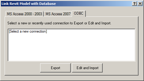

Revit DB Link allows you to export Revit model data to a database, where you can edit the data and import it back into the model.
There are two types of databases you can use with Revit DB Link:
