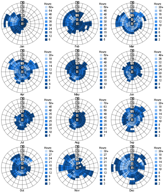

Monthly Wind Roses
These wind roses show frequency distribution for each month of the year.
