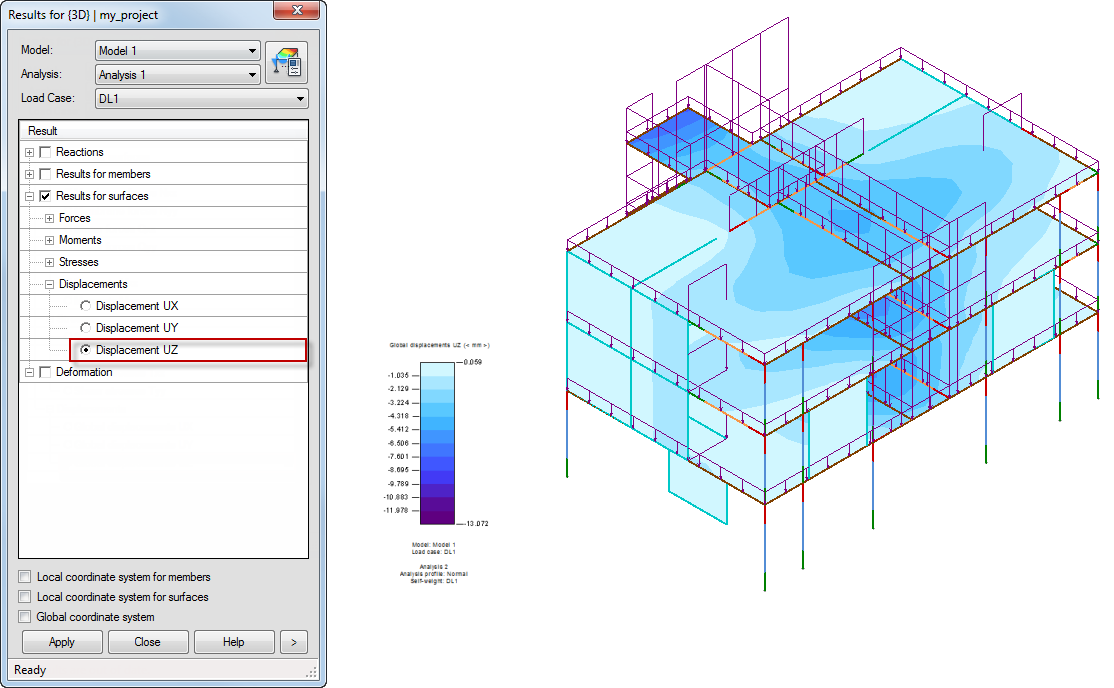

  • Deformation
Note: For panels you can display only one result type at a time.
Example of displacements in the 3D analytical view
