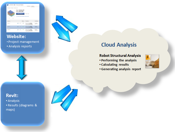

The Structural Analysis for Autodesk Revit tool lets you perform cloud-based structural analysis of a Revit analytical model. Results are displayed in the Revit project and can be further explored.
To prepare Revit analytical models for analysis, you need to install the Structural Analysis for Autodesk Revit add-in on the computer with Revit installed. After a model has been prepared, you can submit the analysis from Revit or from the Autodesk® 360 Structural Analysis website.
The Structural Analysis for Autodesk Revit add-in uses the Autodesk® Robot™ Structural Analysis Professional engine.
Autodesk® Robot™ Structural Analysis Professional is integrated graphic software for modeling, analyzing and designing various types of structures. You can use it to create structures, perform the structural analysis, and verify results.
Structural Analysis for Autodesk Revit: Workflow
