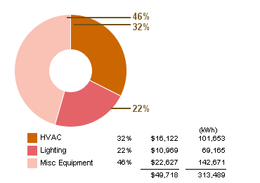

When reviewing an energy analysis in the Results and Compare dialog, this chart shows estimated electricity use for major end uses, including HVAC, lighting, and equipment.
Note: Available as an Autodesk® Subscription Benefit.
Equipment includes computers, elevators, and miscellaneous appliances.
For each end use, the chart shows the percentage of total electricity usage, costs, and kilowatt-hours. By understanding the end use that requires the most electricity, you can focus on strategies to reduce overall energy consumption for the project.
