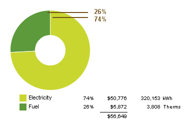

Annual Energy Use/Cost
When reviewing an energy analysis in the Results and Compare dialog, this chart compares estimated energy use for major fuel versus electricity.
Note: Available as an Autodesk® Subscription Benefit.
Major fuels include heating oil, natural gas, propane, and other resources. The percentage break-down is based on usage (using a common unit of kBtu), not costs.
Annualized energy cost and consumption information can inform building energy cost comparisons and early design decisions. Costs are estimated using state-wide, territory-wide, or nation-wide average utility rates.
For this chart, energy usage is converted as follows:
