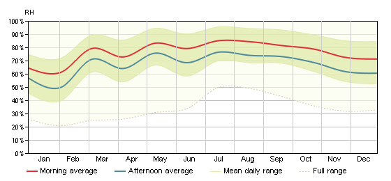

When reviewing an energy analysis in the Results and Compare dialog, this chart shows the annual range of relative humidity.
Note: Available as an Autodesk® Subscription Benefit.
Relative humidity is the amount of water vapor that exists in a gaseous mixture of air and water vapor.
Because the humidity can vary greatly throughout the course of one day, and is typically higher in the mornings, the chart shows the morning average and the afternoon average.
The mean daily range is the difference between the averages of the daily maximum and minimum relative humidity for the month. The full range is a record of the absolute maximum and minimum relative humidity for the month.
