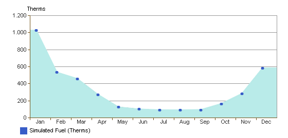

Monthly Fuel Consumption
When reviewing an energy analysis in the Results and Compare dialog, this chart displays the project's estimated fuel usage by month.
Note: Available as an Autodesk® Subscription Benefit.
If the project uses fuel for heating (as opposed to electric heating sources), fuel usage increases during the colder months of the year.
