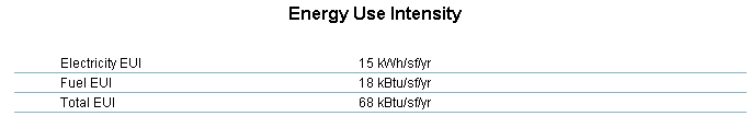

Energy Use Intensity
When reviewing an energy analysis in the Results and Compare dialog, this table provides information about energy use per unit floor area.
Note: Available as an Autodesk® Subscription Benefit.
Because Energy Use Intensity (EUI) is a per-area metric, it is a convenient method of comparing project energy consumption when analyzed buildings have different sizes.
Parameter Description
Electricity EUI A measure of the annual electricity usage per floor area.
Fuel EUI A measure of the annual fuel usage per floor area.
Total EUI A measure of the combined electricity and fuel used by the project, per floor area per year.
For this metric, the electricity usage is converted as follows:
  • IP units: 1 kWh = 3.412 kBtu
  • SI units: 1kWh = 3.6 MJ
