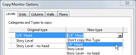

    On the Copy/Monitor Options dialog, tabs contain options for different element types. Use these options to make the copied element different from the original element in various ways.
  3. Click the tab for the type of element to copy, and change values in the New type column as desired:
    If you want to... Then...
    Prevent Revit from copying elements of a certain type Locate the element type in the Original type column. On the same line in the New type column, select Don’t copy this Type.
    Apply a different type to copies of selected elements Locate the element type in the Original type column. On the same line in the New type column, select the type to apply to the copies.
