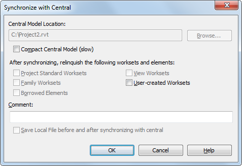

If you want to modify the Synchronize with Central settings before you synchronize with central: Click Collaborate tab
Synchronize panel
Synchronize with Central drop-down
(Synchronize and Modify Settings). The Synchronize with Central dialog displays.
If necessary, click Browse to specify a different path for the central model. Specify the new path in the Central File Location dialog, and click OK.
