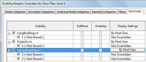

Parameters that control the visibility and graphics of linked Revit models are grouped under their own tab, Revit Links, in the Visibility/Graphics dialog.
This dialog is arranged in a tree structure with the parent nodes referring to separate files (the primary linked model), and the child nodes referring to instances (copies) of the model in the project. Changing the parent node affects all instances, while changing a child node affects only that instance.
The Revit Links tab in the Visibility/Graphics dialog contains the following columns:
