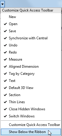

The Quick Access toolbar contains a set of default tools. You can customize this toolbar to display the tools that you use most often.
The Quick Access toolbar can display above or below the ribbon. To change the setting, on the Quick Access toolbar, click Customize Quick Access Toolbar drop-down
Show Below the Ribbon.
Navigate the ribbon to display the tool that you want to add. Right-click the tool, and click Add to Quick Access Toolbar.
If you removed default tools from the Quick Access toolbar, you can add them again by clicking the Customize Quick Access Toolbar drop-down, and selecting the tool to add.
To make a quick change to the Quick Access toolbar, right-click a tool on the Quick Access toolbar and select one of the following options:
To make more extensive changes, on the Quick Access toolbar drop-down, click Customize Quick Access Toolbar. In the dialog, do the following:
