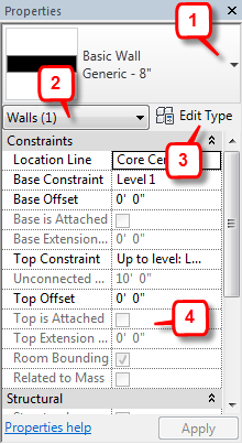

  1. Type Selector
  2. Properties filter
  3. Edit Type button
  4. Instance properties

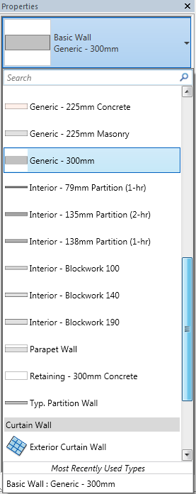

When a tool for placing elements is active, or elements of the same type are selected in the drawing area, the Type Selector displays at the top of the Properties palette. It identifies the currently selected family type and provides a drop-down from which you can select a different type.
When you click the Type Selector, a search field displays. Enter keywords in the search field to quickly find the content type that you need.
Note: The search feature is only available for users who are students or Autodesk Maintenance and Desktop Subscription customers for Revit 2015 software releases.
To make the Type Selector available when the Properties palette is closed, right-click within the Type Selector, and click Add to Quick Access Toolbar. To make the Type Selector available on the Modify tab, right-click within the Properties palette, and click Add to Ribbon Modify Tab. Each time you select an element, it will be reflected on the Modify tab.

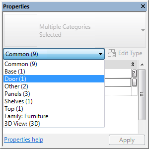

Immediately below the Type Selector is a filter that identifies the category of the elements a tool will place, or the category and number of elements selected in the drawing area. If multiple categories or types are selected, only the instance properties common to all display on the palette. When multiple categories are selected, use the filter’s drop-down to view only the properties for a specific category or for the view itself. Selecting a specific category does not affect the overall selection set.
Edit Type button
Unless elements of different types are selected, the Edit Type button accesses a dialog where you can view and modify the type properties of the selected element (or those of the view, depending on how the Properties Filter is set.
Note: You can also access the type properties for the active tool or currently selected elements by clicking Modify | <Element> tabProperties panel (Type Properties). When available, this button always accesses type properties for the selected element(s), or for a family type selected in the Project Browser. The Edit Type button on the palette, however, accesses type properties for the entity whose instance properties are currently displayed, which could be either the active view, the active tool, or a currently selected element type.
Instance properties
In most cases (see exceptions in note below), the Properties palette displays both user-editable and read-only (shaded) instance properties. A property may be read-only because its value is calculated or assigned automatically by the software, or because it depends on the setting of another property. For example, a wall’s Unconnected Height property is only editable if the value of its Top Constraint property is Unconnected. For specific dependencies, see the instance property descriptions for individual element types.
