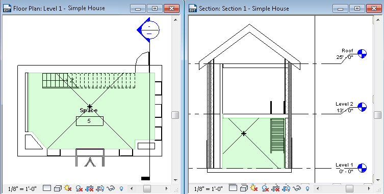

  5. Close all views, except the section view and the floor plan where you want to place the space, and enter WT on the keyboard to tile the 2 views.
    You can also click View tabWindows panel(Tile).
  6. Click in the section view to make it active, and enter VG on the keyboard.
  7. On the Model Categories tab of the Visibility Graphics dialog, scroll down to Spaces.
  8. Expand Spaces, select Interior and Reference (if you want to display reference crosshairs), and click OK.
  9. Use the same method to make spaces visible in the floor plan view.

  12. In the floor plan view, move the cursor over an area in the building model, and click to place a space.

  17. In the section view, verify that the shaded area representing the volume of the space is constrained from the base level to the next level above, and that unshaded areas (caused by such things as cavities or shafts) do not exist.
  18. If the space is constrained by a ceiling or other room bounding component instead of the level above, verify that the upper limit of the space is specified to the next level above, and redefine the space vertically, if necessary.
    You must also resolve unshaded areas such as cavities, shafts, and chases.
