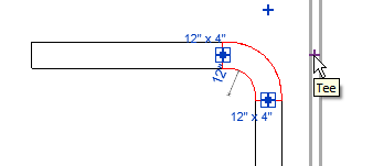

Select the elbow you want to upgrade.
Click the plus symbol (+) next to the fitting.
The elbow is changed to a tee.

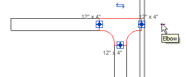

To change the tee back to an elbow, click the minus symbol (-) next to the fitting.
