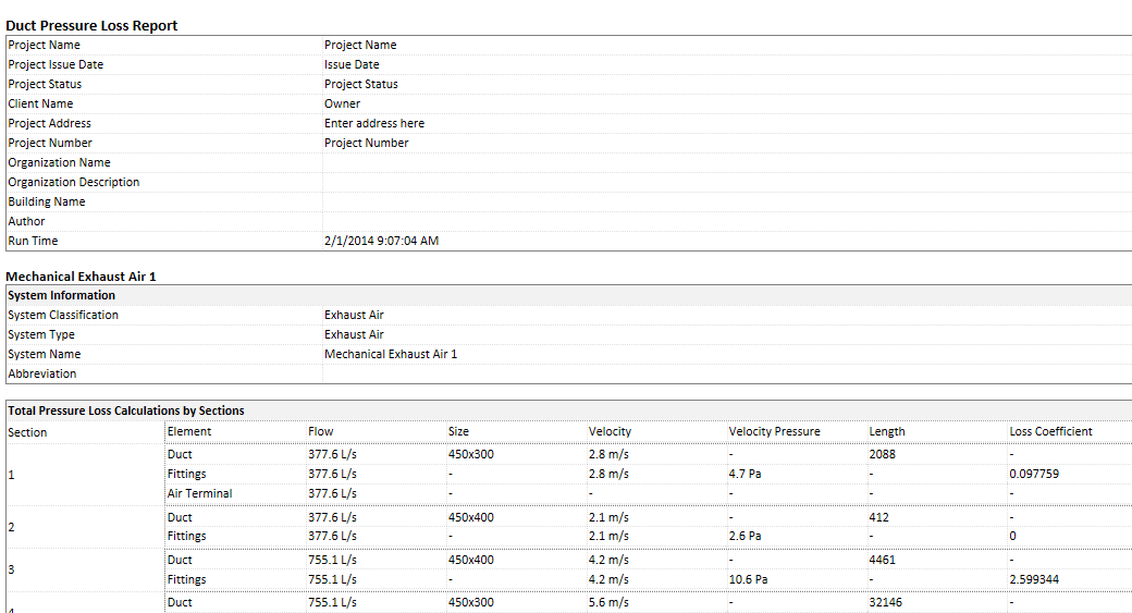

You can generate a pressure loss report for duct or pipe systems in your project.
To generate the report, first, specify the systems to include in the report, then set up the report. When setting up the report, you can specify which fields, such as diameter, height, and width, are included. You can also specify whether additional information such as system information and critical path is displayed in the report. The output from the report can be saved as an HTML or CSV file.
Reports & Schedules panel
(Duct Pressure Loss Report) or
(Pipe Pressure Loss Report) and select one or more systems in the Pressure Loss Report - System Selector dialog. To filter the systems in the list, click System Type Filter.
You can select a system for which calculations are set to All. If calculations are set to Flow Only or None, a warning displays or the system will not display in the list.
A pressure loss report cannot be generated for a fire protection system, or a gravity flow system, such as a sanitary system.
A system must be well connected in order to generate a pressure loss report. Use the System Inspector to determine if a system is well connected before attempting to generate a pressure loss report.
After you select the systems you want to include, you can set up the report.
The duct pressure loss and pipe pressure loss reports each have their own report format. They are saved in the same location as the default template.
