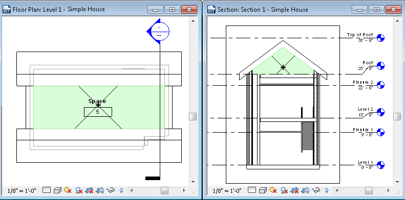

  16. In the floor plan view, move the cursor over an area in the building model, and click to place a space.
    Note: Spaces can only be placed in floor plan views.
  17. Click Modify.
  18. Select the space.
  19. On the Properties palette, under Energy Analysis, do one of the following:
    • Select Occupiable, if the space will be occupied.
    • Clear Occupiable, if the space will be unoccupied.
  20. Click OK.
    Note: If you place a space in an area that contains a room, the Occupiable parameter is automatically selected. This defines the space as occupied. If the area does not contain a room, the Occupiable parameter is automatically cleared. This defines the space as unoccupied. You can always redefine the space by selecting or clearing this parameter. The Occupiable parameter affects the heating and cooling loads analysis.
  21. In the section view, verify that the shaded area representing the volume of the space is constrained from the base level to the roof, and that unshaded areas (caused by such things as cavities or shafts) do not exist. This provides for a more accurate volume calculation.
  22. If the space is not constrained as specified, in the section view, verify that the upper limit of the space is specified to the level above the roof, and redefine the space vertically, if necessary.
    You must also resolve all unshaded areas.
