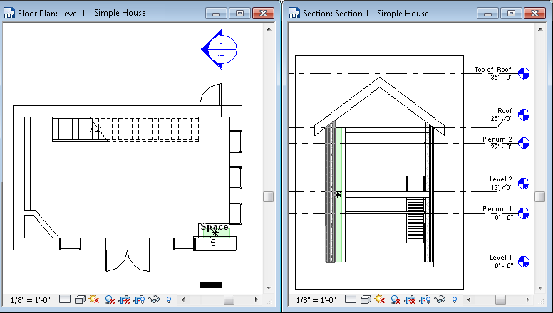

  17. In the floor plan view, move the cursor over the shaft area in the building model, and click to place a space.

  22. In the section view, verify that the shaded area representing the volume of the space is constrained from the base level to the level at the top of the shaft, and that unshaded areas (caused by such things as cavities) do not exist. This provides for a more accurate volume calculation.
  23. If the space is not constrained as specified, in the section view, verify that the upper limit of the space is specified to the level at the top of the shaft, and redefine the space vertically, if necessary.
    You must also resolve all unshaded areas.
