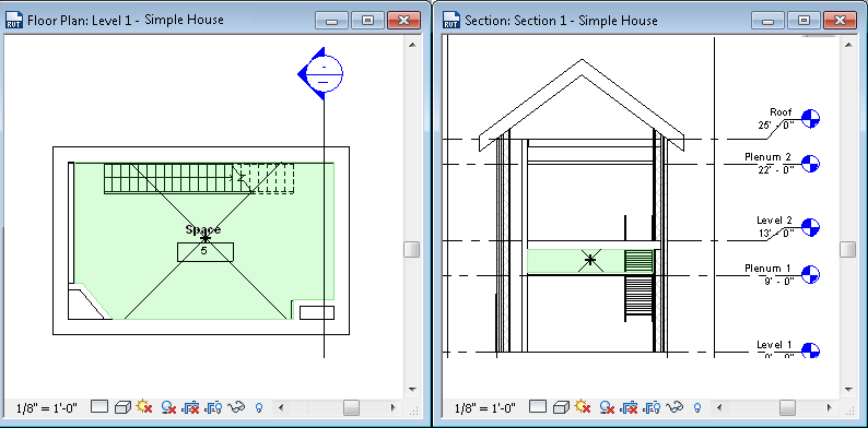

  12. In the Project Browser, double-click the floor plan view that is associated with the plenum level.
    This view contains the plenum areas in which you need to place spaces.
  13. Close all views, except the section view and the plenum level floor plan view, and enter WT on the keyboard to tile the 2 views.
    You can also click View tabWindows panel Tile.

  24. In the floor plan view, move the cursor over a plenum area and click to place a space.
    Note: Spaces can only be placed in floor plan views.

  28. In the section view, verify that the shaded area representing the volume of the space is constrained from the plenum level to the floor above, and that unshaded areas (caused by such things as cavities or shafts) do not exist. This provides for a more accurate volume calculation.
  29. If the space is not constrained as specified, in the section view, verify that the upper limit of the space is specified to the level above, and redefine the space vertically, if necessary.
    You must also resolve all unshaded areas.
