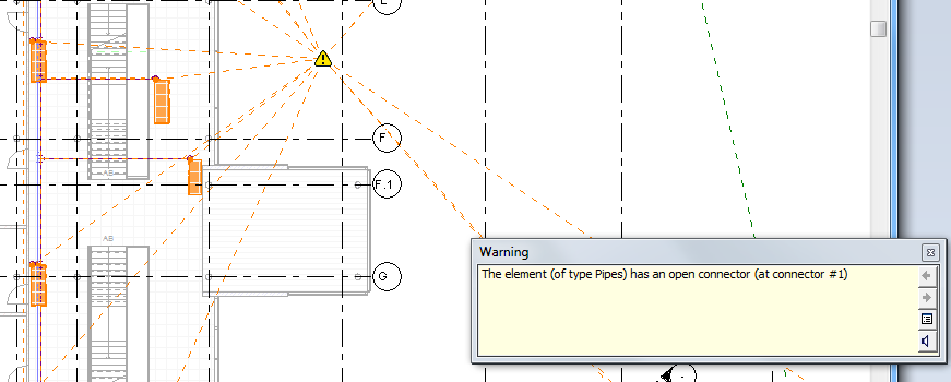

Revit displays graphical warning markers and web lines for invalid pipe systems in the current view. Warnings display when the following conditions are found:
  • The system is not well connected.
    A system is considered not well connected when elements in the system are not connected into a single physical network. For example, a system with one or more fixtures not connected in a single network of pipe is considered not well connected
  • There is a flow/demand configuration mismatch.
  • There is a flow direction mismatch.
Click a warning marker to display a related warning message. In the related warning message, click the arrow buttons as needed to scroll the list of warning messages. Click Expand Warning Dialog to view the details of the warning message.

In the following example, Pipe disconnect markers were selected.
Click a warning marker to display a related warning message. Click Expand Warning Dialog to view the details of the warning message.
