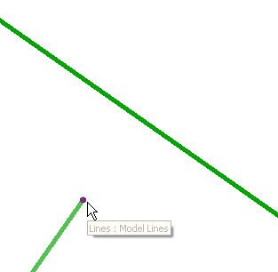

- Join selected endpoints (of walls, for example) with a selected line.

Selected point to align to an element
Element and point joined

Note: Before selecting, move the cursor over the element until the part of the element to align with the reference element is highlighted. Then click it.
