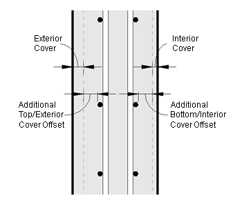

Area reinforcement properties for structural walls are identified as either exterior or interior to reflect the vertical orientation of the rebar. Properties for structural floors are identified as either top or bottom to reflect the horizontal orientation.

| Additional Top/Exterior Cover Offset | Specifies an additional offset from the top/exterior rebar cover. This allows placing multiple rebar elements together in different area reinforcement layers. |
| Additional Bottom/Interior Cover Offset | Specifies an additional offset from the bottom/interior rebar cover. This allows placing multiple rebar elements together in different area reinforcement layers. |
