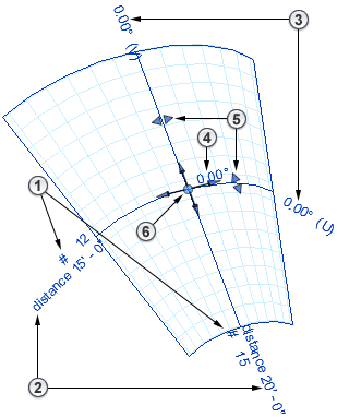

Use the Face Manager to edit the UV grids of a divided surface in the conceptual design environment.
Fixed Number | Click the number value in the drawing area and enter a new quantity. |
Fixed Distance | Click the distance value in the drawing area and enter a new distance. Note: The Distance drop-down list on the Options Bar also allows for a minimum or maximum distance, rather than an absolute distance. This option is only available when the surface is initially selected (not in the Face Manager).
Grid Rotation | Click the rotation value in the drawing area and enter a new angle for either grid. |
All Grid Rotation | Click the rotation value in the drawing area and enter a new angle to rotate both grids equally. |
Grid Belts | Click and drag these controls to reposition the belts along their respective grids. Each grid belt represents the line along the surface from which the distance between grids is measured. Along curved surfaces, the distances can be proportionately different along a line. This distance is measured by chords, not curve lengths. |
Justification | Click, drag, and snap this widget to a surface edge (or center) to justify the UV Grid. The new location is the origin for the UV Grids layout. The Align tool can also be used to align a grid to an edge. |
Each of these parameters can be specified in the Options Bar or Properties palette.
