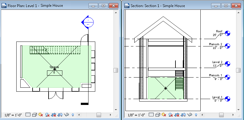

  1. In the Project Browser, open a floor plan that contains the area where you want to place a space.
    Next, you create a section view to verify the space as you place it.
  2. You can use an existing section view but make certain that the section line intersects the area in which you are placing the space. In the following examples, only one section view is needed because each level consists of a single space. You may need additional section views depending on the complexity of your design.
    Note: Spaces do not display in elevation views.
    Place the section in the floor plan so that the section line intersects the area in which you are placing the space as shown.
  3. Double-click the section to open it.

  14. Close all views, except the section view and the floor plan view where you want to place the space, and enter WT on the keyboard to tile the 2 views.
    You can also click View tabWindows panel Tile.
  15. With the section view active, enter VG on the keyboard.
  16. On the Model Categories tab of the Visibility Graphics dialog, scroll down to Spaces.
  17. Expand Spaces, select Interior and Reference (if you want to display reference crosshairs), and click OK.
  18. Repeat to make spaces visible in the floor plan view.
  19. With the floor plan view active, click Analyze tabSpaces and Zones panel Space.

  21. In the floor plan view, move the cursor over an area in the building model, and click to place a space.
    Note: Spaces can only be placed in floor plan views.

  26. In the section view, verify that the shaded area representing the volume of the space is constrained from the base level to the ceiling level above, and that unshaded areas (caused by such things as cavities or shafts) do not exist. This provides for a more accurate volume calculation.
    Notice that unshaded areas exist for the gaps (left) and the chase (lower right). These need to be resolved.
  27. If the space is not constrained as specified, in the section view, verify that the upper limit of the space is specified to the level above, and redefine the space vertically, if necessary.
    You must also resolve all unshaded areas.
