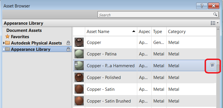

  3. In the Asset Browser dialog, select the asset to add to the material.
    Tip: To locate an asset more easily in the Asset Browser, click one of the column heads to sort the assets by name, aspect, type or category. You can also use the Search bar located above the asset list.
  4. Click the Replace button located to the right of the selected asset.
    The selected asset replaces the original asset in the material and displays in the Material Editor panel. Repeat this procedure to replace other assets.
