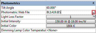

- In the list of parameters, scroll down to Photometrics.
- For Photometric Web File, click in the Value column.
- Click
(Browse).
Note: The Browse button displays after you click in the field.
- Navigate to the desired IES file, select it, and click Open.
