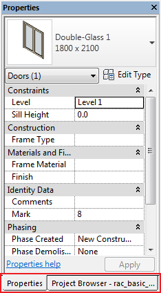

A window group is a way to have more than one window occupy the same amount of space on the screen. When windows are grouped, each window is represented by a tab at the bottom of the group. In a group, click a tab to display that window. You can group or ungroup windows as necessary. In the following image, the Project Browser and Properties Palette are grouped. Notice that the Properties Palette is the active tab.
