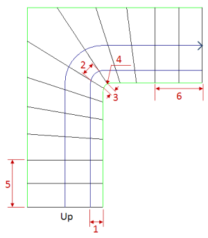

Winders
Note: Winder properties are valid for L-shape and U-shape winder runs.
Winder Style | Specifies the calculation for the winder run steps. Choose from:
Winder Properties (annotated) |
Inside Walk Line Offset | Specifies the distance of the inside walk path from the interior boundary of the winder run. This distance specifies where to measure the Minimum Width on Inside Walk Line. (Refer to 1 in Winder Properties.) |
Minimum Width on Inside Walk Line | Specifies the minimum tread depth measured at the Inside Walk Line Offset. (Read only) (Refer to 2 in Winder Properties.) |
Minimum Width on Inside Boundary | Specifies the minimum tread depth at the interior corners of a winder run. (Refer to 3 in Winder Properties.) |
Fillet on Corner | Select to apply fillet geometry to the interior corner of the L-shape winder run or to both interior corners of a U-shape winder run. |
Fillet Radius | Specifies the radius to be used for the fillet geometry on the interior corners of a winder run. (Refer to 4 in Winder Properties.) |
Parallel Treads at Start | Specifies an optional number of uniform steps to add to the beginning of the winder run. (Refer to 5 in Winder Properties.) |
Parallel Treads at End | Specifies an optional number of uniform steps to add to the end of the winder run. (Refer to 6 in Winder Properties.) |
