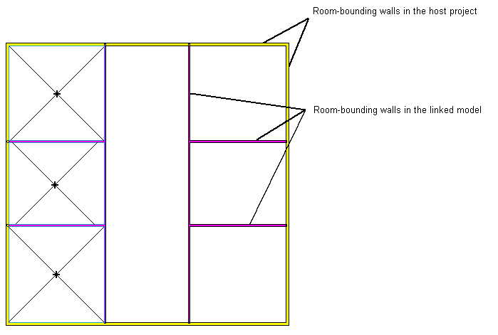

When you link Revit models together, by default Revit LT does not recognize room-bounding elements in the linked model.
If you try to place a room between walls in the host project and walls (or other elements) in a linked model, Revit LT does not automatically recognize the room-bounding elements of the linked model. However, you can force Revit LT to recognize the room-bounding elements of a linked model. See Use Room Boundaries in a Linked Model. 
Placing rooms in a host project (building exterior) using walls in a linked model (building interior)
