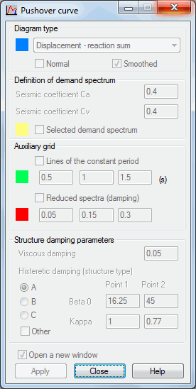

The option is available by clicking Results menu > Advanced > Capacity Curve and displays the following diagrams:
Based on the capacity spectrum, the performance point is calculated (code ATC 40 chapter 8.2.2.1.3), which determines the structure response (maximal displacements) to the specified ground movement caused by an earthquake.
The dialog lets you select 1 of the following types of diagrams:
The options: Normal and Smoothed are available only for the Capacity spectrum diagram. Selecting the Smoothed option results in smoothing the diagram that is displayed.
In the Definition of demand spectrum field, you can determine the demand spectrum (spectrum of ground movements during an earthquake). The demand spectrum is defined using the seismic coefficients Ca and Cv. (See code ATC-40 Chapter 4.) Selecting the Selected demand spectrum option displays a diagram created out of the intersections of the constant period lines with the appropriately calculated reduced spectra.
The options in the Auxiliary grid field include:
In the Structure damping parameters field, you can define 2 types of structure damping:
For the histeretic damping, the structure type (A, B, or C) is selected. The parameters Beta0 and Kappa (applied to calculate the effective damping) are calculated by Robot and are displayed in the proper fields on a gray background. You can also specify these values if the Other option is selected. The fields for Point1 and Point2 become available. Values of the Beta0 and Kappa coefficients must be positive.
After defining the enumerated parameters and clicking Apply, a relevant diagram is displayed.
